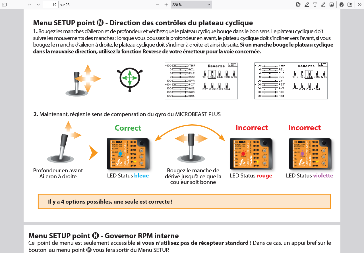

titusmax 0 Posted June 3 Report Share Posted June 3 sur microbeast 5.1 le point M en setup je n'arrive pas à avoir la bonne compensation j'ai bien la led bleue mais il compense à l'envers ? Quote Link to post Share on other sites
paulinfrance 7 Posted June 4 Report Share Posted June 4 Aileron ou élévateur reverse ?,,, Ou essai de croiser les deux servos des ailerons sur le microbeast, ou rx. Quote Link to post Share on other sites
snake 233 Posted June 10 Report Share Posted June 10 reverifie l'orientation du beastx menu setup point A, ça provient certainement de la Quote Link to post Share on other sites
