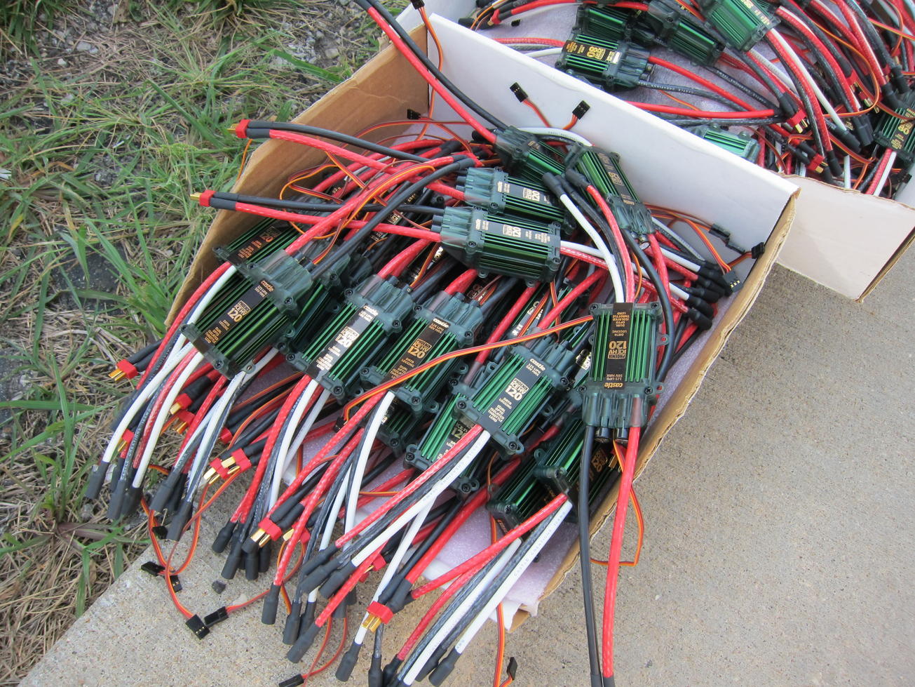

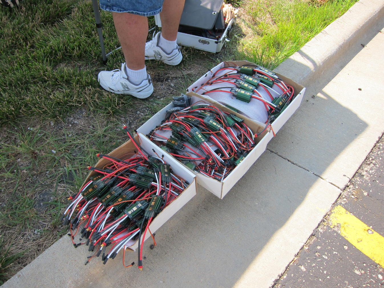

We were able to test -- and destroy -- a number of HV 120s last week with the help of a very talented heli pilot. Through this process we determined that some, again some, setups stressed a particular component in a way that caused controllers to fail instantly. Adding capacitance to the setup did show promise as a solution but it is a rather cumbersome solution.
Unrelated to this particular problem, Castle has been working with a major component vendor to build these particular components to our specifications. We have just received a small quantity of sample parts for evaluation.
We gave the new components a shot in the HV 120s and found that they were a very tidy and seemingly complete solution to the matters plaguing that design.
